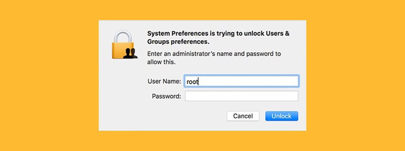

On Wednesday 29th November Apple issued an emergency software update for the High Sierra version of its MacOS that fixes a glaring vulnerability.
The flaw, discovered by software developer Lemi Orhan Ergin let you gain access to any Mac running on High Sierra by simply typing "root" in the username field, leaving the password blank and then clicking the login button a few times.

Late Tuesday, Apple confirmed it was working on a software update to fix the flaw and issued step by step instructions to help customers protect their machines by enabling the root user or changing the root password. Within 24 hours the company were advising users that Security update 2017-001 would be automatically installed on all systems running the latest version (10.13.1) of MacOS High Sierra.
How to install and confirm the Security update:
  1. Open the Mac App Store and the update will be available to download.
  2. Once installed go to your Applications folder and open the Terminal app in the Utilities folder.
  3. Type what/usr/libexec/opendirectoryd and press Return.
  4. If the system update 2017-001 was installed successfully, you will see one of these project version numbers:
               - opendirectoryd-483.1.5 on macOS High Sierra 10.13
               - opendirectoryd-483.20.7 on macOS High Sierra 10.13.1
